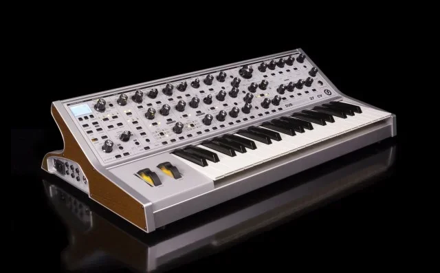

Nun scheint wohl zum Moogfest eine CV-Version in Produktion zu gehen:
Quelle: http://blog.zzounds.com/2017/05/17/moog-subsequent-37-cv-revealed-moogfest-2017/
  • #1.715
Re: Moog Sub 37 Tribute?
Sieht aus wie das, was rauskommt, wenn ein Kurzwarenladen eine Industrieküche bespringt. Da find ich meinen Sub37 deutlich hübscher.
  • #1.716
Re: Moog SubSequent 37
offizielle produktankündigung:
Today we are excited to announce the Subsequent 37 CV. This limited-edition redesign of the ultra-powerful Sub 37 Tribute Edition analog synthesizer is limited to 2000 pieces worldwide, with the first 125 units built live on-site at Moogfest 2017. Anchored by a pair of solid aluminum side pieces inset with North American hardwood and affixed to a rugged steel and aluminum enclosure, it features four assignable CV outputs and two assignable Gate outputs for interconnectivity with large-format and Eurorack modular systems, an upgraded keybed for improved playability, a high-powered headphone amplifier for live-monitoring, and a modified analog signal path.(...)
The Subsequent 37 CV’s mixer now has double the headroom of the Sub 37 Tribute Edition. Taking advantage of the mixer’s newfound flexibility, the gain-staging of the Ladder filter has been reshaped to boost harmonic saturation and analog compression. Completing the sonic evolution is a re-tuned Multidrive circuit that extends well beyond the grit and growl of the original Sub 37.
Subsequent 37 CV production is limited to 2000 pieces worldwide. Each instrument is lovingly handcrafted by Moog employee-owners. The first 125 units are available for purchase exclusively through GuitarCenter.com, and on-site at the Moog Pop-Up Factory during Moogfest 2017, May 18-21.

...erinnert mich an den MS-20mini Albino,...ist davon einer gekauft worden :selfhammer:
...und 200,-€ mehr....wofür genau?

Spannend, was "assignable" dann für die CV-Outs tatsächlich bedeutet...
  • #1.720
Re: Moog Subsequent 37 // Tribute? 4xCV 2x Gate mehr
Frei routbar halt. Für mich fehlt nur 2x CV in für Duophonie-Steuerung von außen. Sonst ist das fein, dumm nur für die, die schon einen Sub 37 haben und das gerne soooo hätten.

Würde mich freuen, wenn ich meinen Sub 37 mit den CV Out's nachrüsten könnte. Beim Little Phatty wurde eine solche Nachrüstoption ja mal angeboten.
Die CV Out's waren auch ein Grund mit, warum ich meinen LP, der damit ausgestattet ist, noch behalten habe. ;)
  • #1.723
Wenn ich mich recht erinnere, haben Moog bei Erscheinen des Sub 37 darauf hingewiesen, dass dies technisch nicht möglich sei. Insofern würde ich davon ausgehen, dass man das Innenleben des Subsequent 37 dahingehend modifiziert hat - also jenseits einer üblichen Nachrüstung.

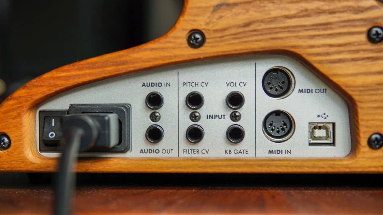

Kann mir jemand freundlicherweise folgende Fragen beantworten:
1) Ist es beim Sub37 von außen über Pitch/Gate (oder Filter CV) möglich die Intensität der Filter Hüllkurve zu steuern?
2) Geht das über Gate?
3) Der Filter CV bewirkt vermutlich so etwas wie Keytracking?!
4) Praktisch könnte man doch auch über den Filter CV mit einer zusätzlichen Hüllkurve aus einen Modular System das Filter modulieren?

Kein Problem. Der hat ja Steuereingänge für Pitch, Filter und Amp.
damit ist klar, was steuerbar ist.
Filter, Tonhöhe aller OSCS gemeinsam und Lautstärke.
gilt ja für beide. Also…
  • #1.739
Also Gate ist mehr als an/aus richtig? An/aus + Intensität (Dynamik) ?
Über KB CV könnte man die Dynamik ja nochmal von der VCA Env entkoppeln, unter Anwendung des Modular Systems.
Wird das in der Praxis wohl auch tatsächlich SO funktionieren? Ich bin da noch etwas skeptisch, nachher haben die innen drin doch die Drähte anders verbunden.... :)
  • #1.740
Gate ist Trigger der Hüllkurve, nicht mehr. Dynamik enthält es nicht.
Nur bei MFB gibt es im Drummodul so eine Option und ist phys. dann trotzdem VEL auf ENV Amount.
Das geht hier also nicht.
Du könntest eine externe ENV nutzen und die steuerbar machen und das auf Filter oder Amp stecken.
Das hier sind ja Eingänge. Geht auch nichtmodular.
So das Gerät ext. das kann. im Moog kannst du das natürlich einstellen und Die ENV Amt mit Dynamik steuern. Einfacher Weg.
