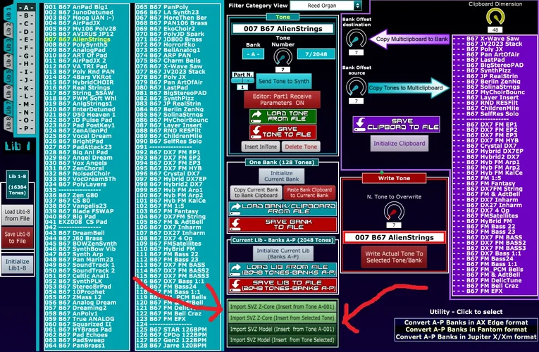

Das ist dann auch oft mühsam, wenn du genau das einstellen willst. In Zen Core würde das ja gehen nur die Juno Oberfläche blockiert das. Eine Option um einen Model Sound in Zen Core umzuwandeln, wäre nice.
with my software for Fantom, AX-Edge, Jupiter-X it is possible to convert any tone library of the JUNO-106 -JX-8P -JUPITER-8 -SH-101 - Juno-60 - JUNO-X engine - JUPITER- models X/XM engine, in the corresponding ZEN-Core tone.
To do this you need:
1) export the model sound(s) to the .sfz file via the synth or Zenology Pro
2) Load the .sfz file into my software so as to have the equivalent ZEN-core tones in the ZEN-core library
3) load the sounds into the synth using the editor.
In this way, for example, I can play ALL the SOUNDS of ALL the Models also on AX-Edge which, as known, only uses ZEN-core sounds.
https://www.benis.it/cm/ZC_Editor/ben67_zeneditor.htm
M.i.a.u.: Jupiter8, aliced25, duplobaustein und eine weitere Person
  • #1.727
Cool, seems that is also very cool für MC707/101 Users, since it is really just “a macro“ and just let me tell you this - it‘s worth a big hug for converting and watching which parameters work 1:1 since it is time consuming but possible.
big up for this job!
