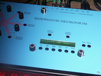

all: play them with VLC..NEURONIUM is FINALLY a 6 FILTER RESONATING VIA FM AND A NEURONAL NETWORK .. the final NEURONIUM has some sort of „sequencer“ animator on board..
finally the resonator went into production.. a good hand ful (24 so far) of them are made in the above shown design..jürgen michaelis of jomox, uhm jürgen michaelis showed the neuronium on the bcn messeparty with video..
very dynamic machine.. neuronal 6 oscs resonating and FM’ing analogue ctrl’ed by DSPs..
just this machine and a nice xbase.

The prototype on the picture right now is the only one that is made yet. I was aware from the beginning that this is not a commercial thing. I will only craft it on order at a relatively high price.
There is my handcrafting and one year work already in it plus the material which is not cheap at all.
Since I knew that I (if ever) would only sell a few units, I realized my very own uncompromising imaginations.

1) the neuronium resonator is a hybrid system that works with resonating filters, FM, DSPs and lots of physics that I will not describe all here ;)
its basic idea is to combine both and let the system filter-amp etc oscillate.. (easy sppoken.. its by far more than this). so it creates multiple resonant peaks.. Jürgen will do some more sounds when he has moved (february) and he promised to me to bring it to the musikmesse in Frankfurt.. and make some more sounds after he has moved (right now!)..
this thing will NOT be cheap and is imo worth a look, its another philosophy of how synths might work.. this is NOT a hoax!! (not a sage-synth ;)) haha)

the other neuronium is an analog/digital neuronal FM network that creates multiple resonating circuits… thats completely different stuff…!!!
