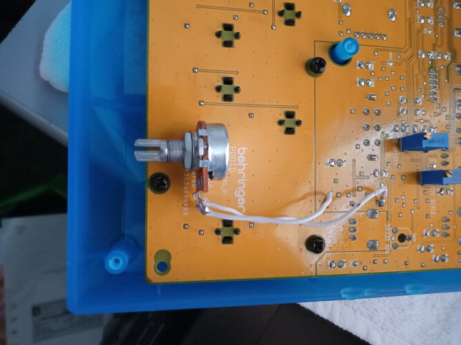

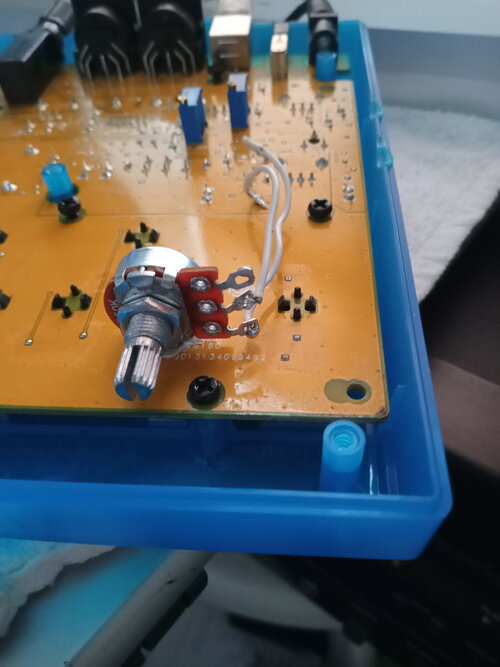

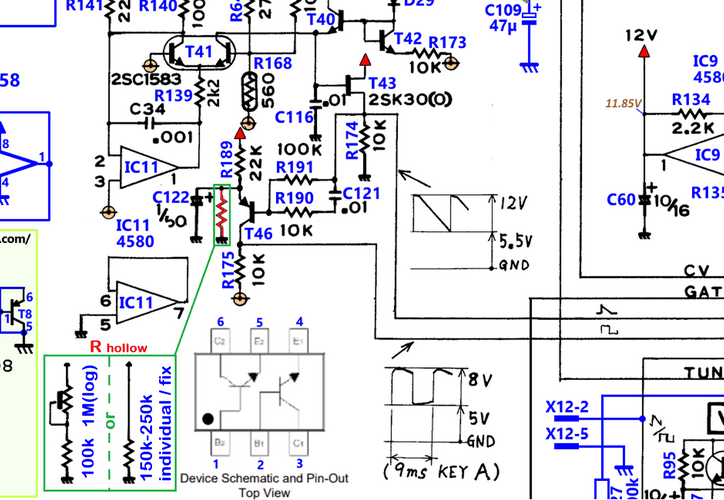

Hi,
Hopefully anyone can advice me further with the hollow square mod ..I have read several different ways of doing this mod .I have removed the R189 and added a 50k potentiometer pictures attached. Unless I have misunderstood the process the square sounds the same as my unmodded TD3 after I find the sweet spot on the potentiometer. Is there something I missed out on?
Looking forward to some expert advice

Fb group suggestions were sound :) - in the end, I’d go by ear

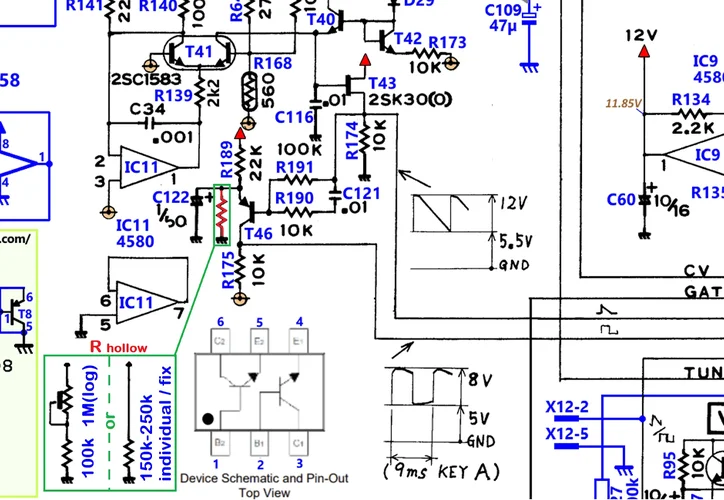

Hi,

Fynkyberlin from that yt vid sent me this - havent tried it, so cant say much about it, but think it makes sense if you dint want to desolder r189. With out pot, this is nicely reversible too. Feel free to up on fb and gs too since you brought itup there :)

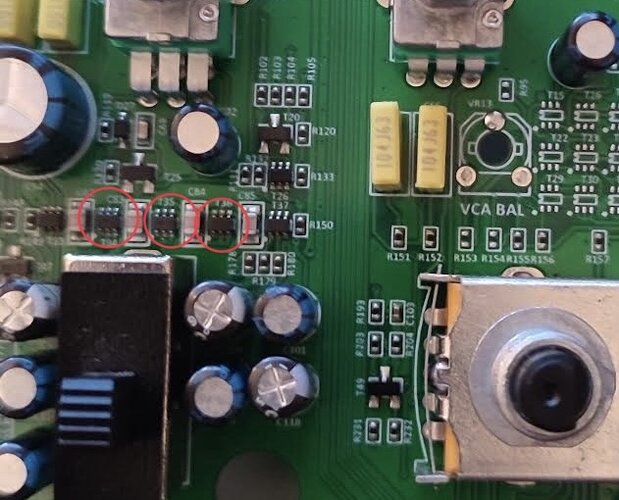

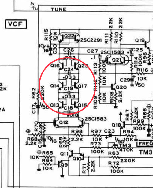

Hier noch was für Leute mit Affinität zur Flohhusthörung :) Mir ging schon immer (meistens mehr als weniger) die schrille Resonanz der TD3 auf die Ohren und ich denke, das liegt mehr an den drei dual SMD NPN (in der og 303 sind das ungematchte npn paare) als an irgendwelchen magischen kondensatoren. War mal so crazy und hab T34, T35 und T36 durch einfache BC550B gewechselt. Hier ein grober Vergleich...

Here's something for people with an affinity for hearing flea coughs. :) The shrill resonance of the TD3 has always annoyed me (mostly more than less) and I think that's more due to the three dual SMD NPNs (in the og 303 these are unmatched NPN pairs) than to any magical capacitors. I was crazy enough to replace T34, T35 and T36 with simple BC550Bs. Here's a rough comparison...

Hey! Both are td3-mo. Second clip has stock transistors replaced with single npn pairs (check schem below for equivalent parts on the 303). Not an easy mod since you need to pull out 3x sot23-6 package transistor pairs and fit 6 new single transistors. The filter ladder being placed very close to the vco waveform switch doesn‘t help either… could be a bit easier on a stock td3 but this is not like the easier tweaks like rubber, accent slew etc…
other mods on this unit here are psu, vca control amount (check here https://maffez.com/?page_id=4682) but that reso a/b only sports differences in regard to the filter ladder transistors. as in the writeup: i think that makes more of a difference than using through hole caps - the 303 clones i find nicest in terms of reso use single npn here too (xoxheart, mam mb33 retro, tt303 mk1, tb-EFA)
