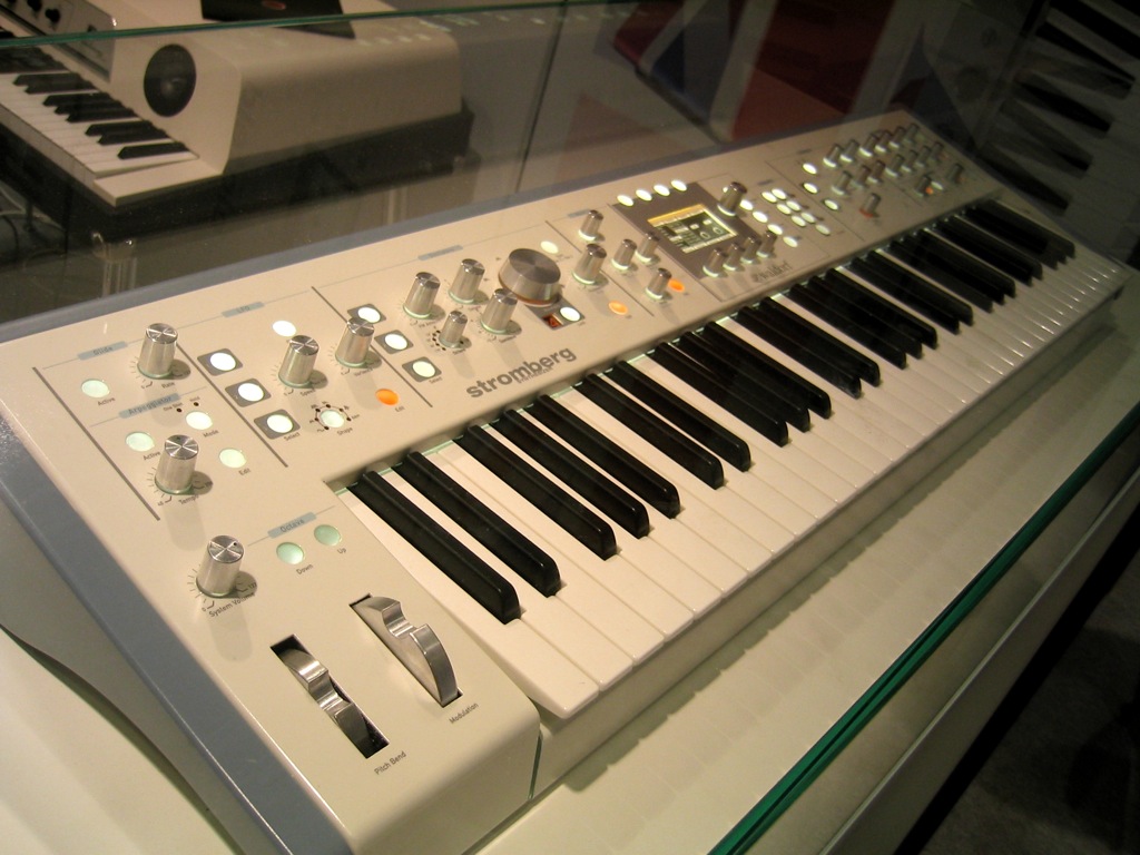

  • #156
matrixsynth.com schrieb:
I read about it on a german discussion board, I didn't understand all of it but it seems there will be a Blofeld Pro Version with extended features and true analog filters coming out in december. I found a photoshop mock up on flicker which might also be a kind of prototype of the real thing......
:mrgreen:
  • #157
:D
Oder er meint Stromberg?
