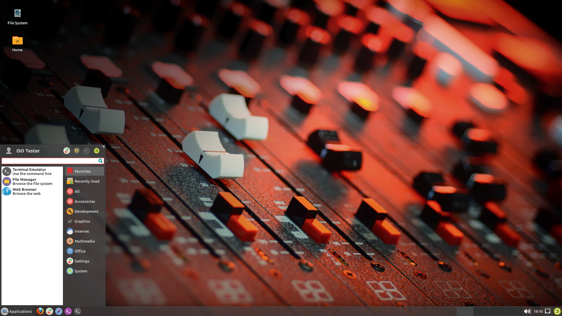

Differences between the 32bit and 64bit ISOs : At a casual glance you are not likely to see much difference between the 32bit and 64bit versions of AV Linux, but there are a few differences noted here:
➢ The 32bit version includes an extra build of Ardour that supports Windows VST Audio Plugins.
➢ The 32bit version has the XFCE4 Panel postioned at the top and 64bit has it at the bottom.
➢ The 32bit version uses the ‘Greybird’ system theme and 64bit uses ‘Zukitre’
➢ The 32bit version has no Chrome Browser because Google discontinued 32bit support.
➢ The 64bit version is 'multiarch' and may have some extra required 32bit packages included.
➢ The 64bit version has preliminary, incomplete Systemback support for UEFI Boot.
➢ *UEFI boot has NOT been tested, User Input Needed!

AVLinux XFCE Desktop:
super tip, hab neue icons installiert und einen passenden style. so muss das sein, schnell, übersichtlich und totally customizable. da fragt man sich wirklich warum man sich jahrelang mit sowas ekligem wie win abgeärgert hat :)
