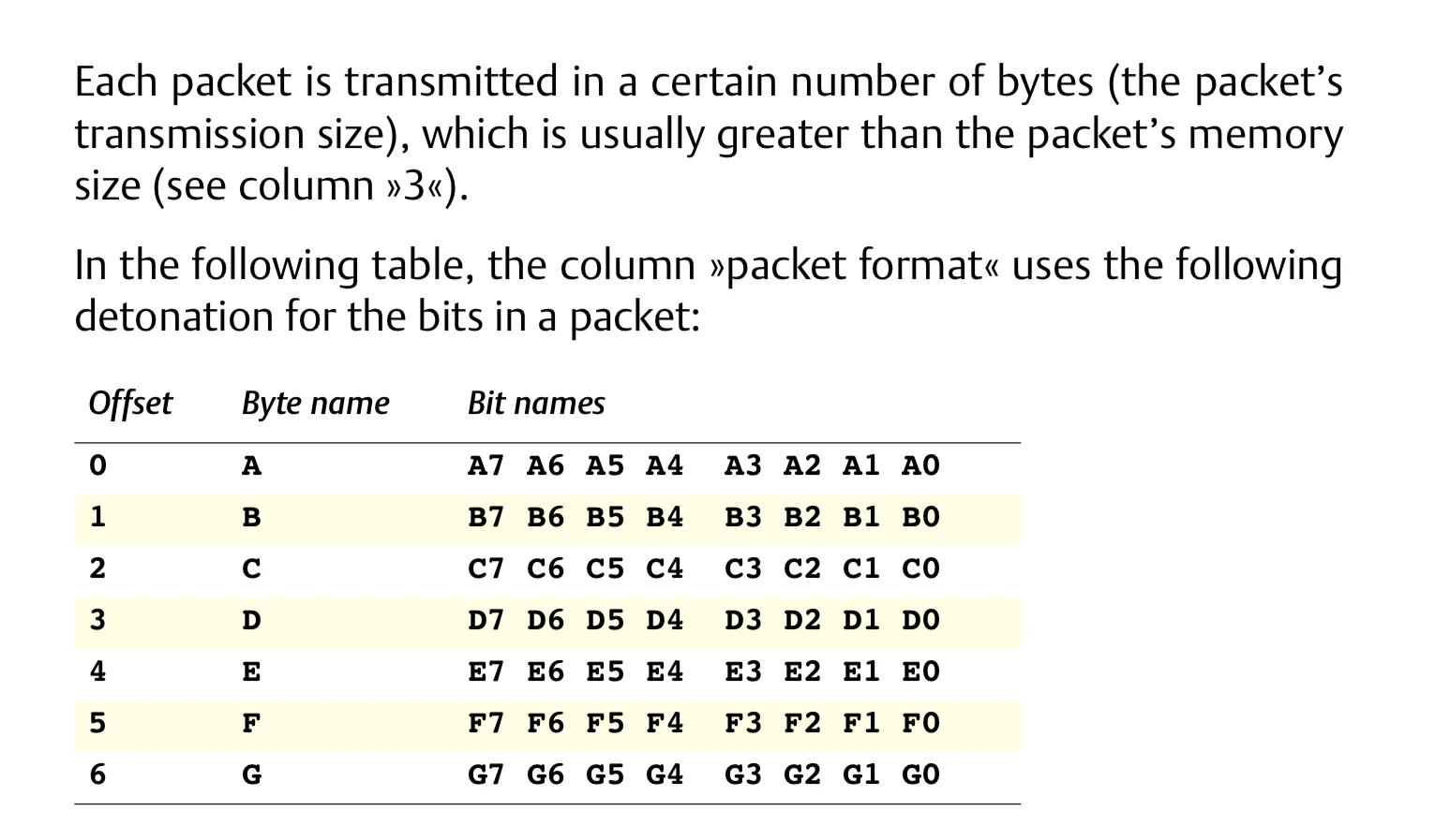

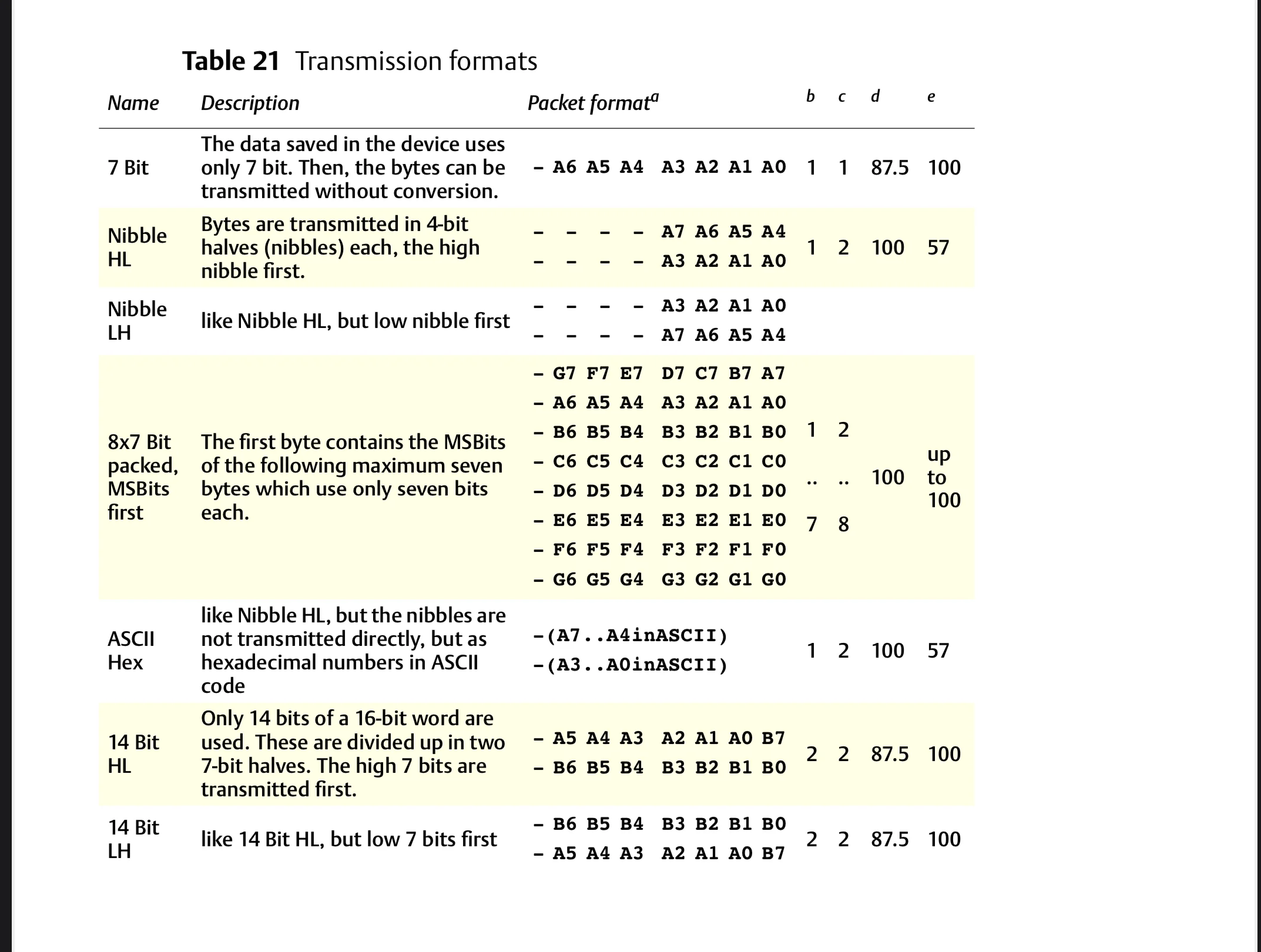

Hier mal ein bissl was zu Übertragungsformaten, Screenshots aus dem SoundDiver Programming Manual:
Außerdem mal den Abschnitt zum Thema Reihenfolge bei den Nibbles:
»big endian« vs. »little endian«
Besides a correct transmission format, there might be another hurdle to clear over for an easy parameter access in a dump. It stems from the fact that there are different view of how to arrange the bits of a 16-bit
word in computer memory. As is well known, a word needs two bytes in memory. Each of the bytes is accessible by an address.
In so-called »big endian« machines (including the Motorola 680x0 CPU’s and thus Atari ST/TT, Apple Macintosh, and Amiga), the bits 15 to 8 of a word are arranged in address n, and bits 7 to 0 are at address n+1 (therefore the name: the number’s »end« is located at the »bigger« address).
In »little endian« machines, it’s the other way around. Little endian machines are all Intel 80x86 processors, and thus all »industry standard« PCs.
Im PPG Wave steckt eine Motorola CPU, daher gilt: Big Endian ist die Reihenfolge der Wahl.
