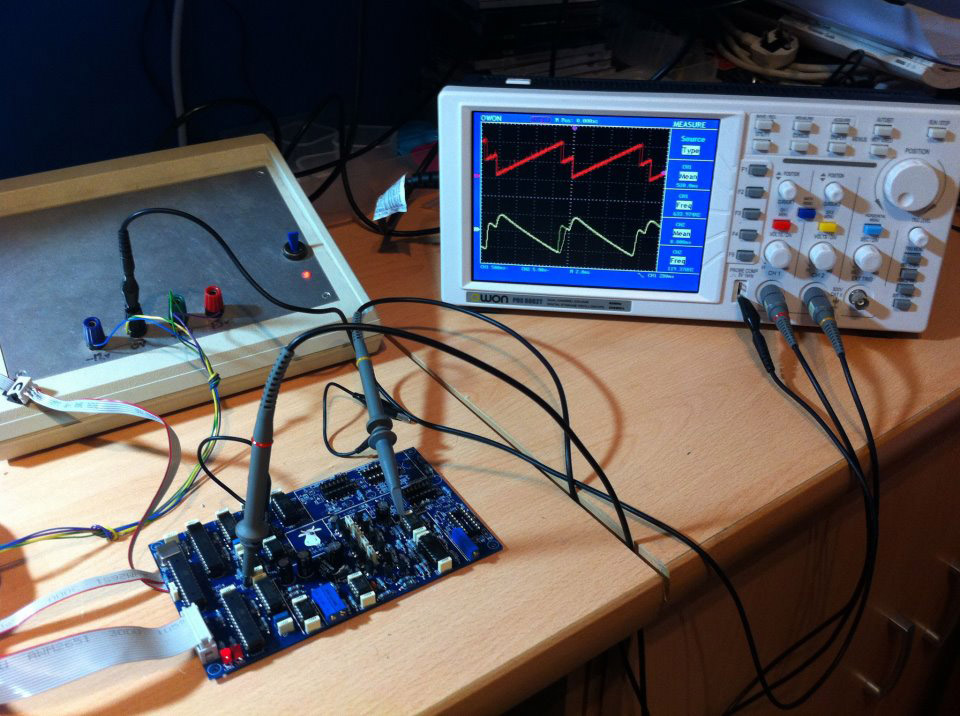

Das ist der Blog von Paul Maddox, er hat unter anderem mal den Monowave gebaut. Nun ist er wohl daran, einen Polysynth auf Basis von einzelnen Voicecards zu entwicklen.

Also, im link steht folgendes ...
Well the last three Zira’s sold fairly quickly, so there’s 20 of them in the world, one of which is mine and I’m not selling it this time, like I did my Monowave.
So, What is Aurora?
Well, my band (Her Dark Embrace) recently went into the recording studio to record our EP. The Engineer was very into electronics and synths and we had some great chats. He asked the question “So, you play keyboards and you build synths, so why don’t you use your own?” Really good question I thought, I replied “Everything I play is chords/pads and I’ve only built monosynths, I’ve never built a polysynth.” to which he asked “why not?“, I had no answer.
So I thought about it and I’d had the basics of a monosynth design on the drawing board so to speak, so whilst on holiday I finished the design and when I returned ordered some PCBs.
Over the last month I’ve begun building a single voice board, first an oscillator, then I ported the code from the oscillator chip in Zira and modified the code, so I have two oscillators with 56 waveforms a piece, with hard sync and adjustable mix.
Next up I added the control CPU, this will be generating the LFO, ADSRs and all the modulation as well as controlling the VCF. It didn’t take long to get the basics working.
Then I added the DACs, I’ve used the DACs on a number of projects now including Zira and GorF-XL so that only took a few hours.
This week I’ve added the VCF components to the PCB and got the VCF working, so it’s making very satisfying “beeoowwwmm” noises.
Next up is to add the resonance VCA, final VCA and a couple of other parts. After that, it’s the coding to do, that’ll take the most time.
If you want to keep up with the latest, keep an eye on my facebook page (https://www.facebook.com/VacoLocoInstruments as that’s where I do most updates, but I’ll try and keep this blog up to date more often.

Will hier keine hoch fliegenden Hoffnungen zerstören, aber folgendes klingt für mich nach Hybrid:
" I’ve begun building a single voice board, first an oscillator, then I ported the code from the oscillator chip in Zira and modified the code, so I have two oscillators with 56 waveforms a piece, with hard sync and adjustable mix."
Soll keine Abwertung sein, ich bin bekennender Digitalliebhaber. Wenn der Osci chip neuen Code geladen kriegen kann ist es aber vermutlich digital (Field-programmable analog array wäre theoretisch möglich, aber unahrscheinlich...).

…das Foto sieht irgendwie nach fpga aus...
Wieso postet da oben jemand den Abschnitt mit dem NJM 2069? Das gehört nicht zu diesem Projekt, sondern zum Zira. Der Aurora hat einen Transistorkaskadenfilter, siehe Facebookseite. Einen FPGA sehe ich da übrigens keinen, XPander, wo soll der denn sein? FPGAs sind allesamt in QFP-Gehäusen untergebracht, das aber sind alles DILs. Oder habe ich Dich da falsch verstanden?
Er wird das so gemacht haben wie beim Shruthi/Ambika: Wellenformen kommen aus der MCU des Voiceboards, also so wie schon beim Monowave.
…der Chip mit dem Kuhkopf sieht so aus wie einer den ich mal auf nem Foto im Netz gesehen habe, die haben manchmal so tolle Bilder auf nem Chip,ich habe davon aber auch keine Ahnung.
"Quarter-Frontier-Problem", "Questioned-Frequiendly-Person"oder was ist QFP-Gehäuse :D ?
Der Kuhkopf ist kein Chip, sondern ein Logo auf der Platine, wie bei Mutable Instruments. Sind halt Linien drum, um offenbar die einzelnen Bereiche der Schaltung optisch zu gruppieren.
…Du hast recht, wenn man mal richtig schaut, sieht man das auch :mrgreen: :selfhammer: ...
Ich hab erst gedacht, wir meinen 2 verschiedene Bilder oder ich hab was übersehen. Ich war auf seiner Webseite bzw Facebookseite, da gabs Bilder von den leeren Platinen mit Logo, da sah man das sehr gut.
