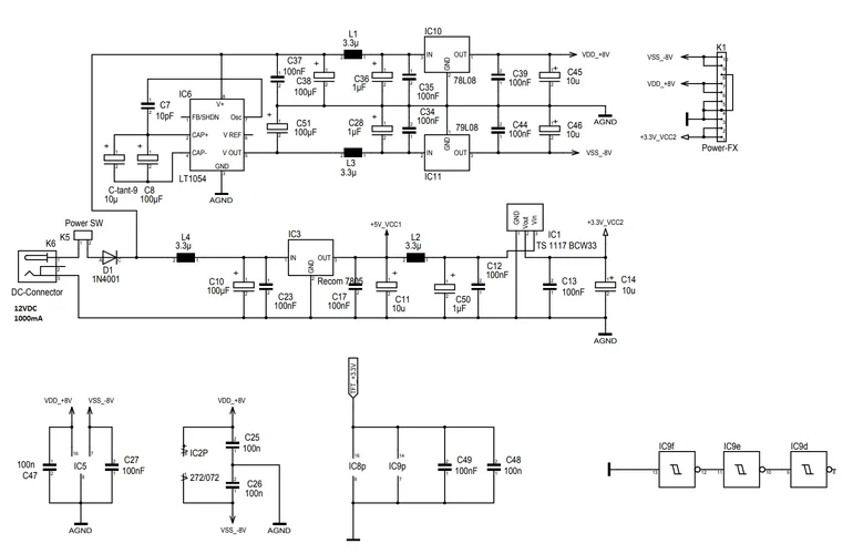

Hi Rolf,
(Sorry I don't speak G e r m a n) Is this the right place to get technical support for the Jeannie HW synth?
I'm have some issues:
1) I don't measure -8 volts. Are there debug steps or tests points to try? The voltage pump IC is in the socket correctly.
2) I installed firmware V1.1.05.X (from the above message). The T41 orange light dimly blinks one time and then stays full on bright orange. Nothing on the LCD screen except full white. I tested the T41 by uploading "blink" sketch and it works.
Any help would be great.
Thanks,
Steve

Hi Steve ,
we need a liitle more information .
What power supply do you have ?
Than , all Voltages are ok , means 5V , 3,3 V , +8V . This is ok ??
Remove the FX Board . Than test all voltages again .
________________________
-8v isn't there .
How it works . + 12 Volt from the Power supoply goes via D 1 direct to the LT1054. Attention there , are the capacitors 10 u tantal and 100 uF in the right direction ?? If not , the LT 1054 don't work .
On the output pin 5 LT1054 you should have round about 10,5...11. volt . This goes via the L3 to the 79L08 , the negative regulator . Du you have take the L . Resistor and Coil looks simila .
Than, normally the LCD works . There is nothing on active parts between the CPU and the LCD . If the LCD doesn't works it can be that there is a short somewhere or a bad solder point ....
If you had buy a complete kit , i had add the 0,66 Firmware . This i had test with your Teensy and it works . Let me know .
g
Andre'
  • #120
Thanks for all the kind replies!
  1. What power supply do you have? 12v center positive 2A
  2. Than, all voltages are ok, means 5V, 3.3V, +8V. this is ok ?? Yes
  3. Remove the FX Board. Than test all voltages again. No FX board attached.
  4. I bought the complete kit. yes
I had the 10u tantalum cap in backwards. The power IC LT1054 or 10u tantalum Cap got hot. I removed the 10u tantalum and it is now correct. Did this mistake destroy caps or power IC?
Voltage from pin 3 (Gnd) to...
  1. Pin 1 (FB/SHDN) = 1.75v
  2. Pin 2 (Cap+) = 1.27v to 1.31v
  3. Pin 4 (Cap-) = -0.66v
  4. Pin 5 (Vout) = -0.57v
  5. Pin 6 (Vref) = 2.57v
  6. Pin 7 (Osc) = 1.93v
  7. Pin 8 (v++) = 11.62v
Power Supply measured 12.42v
I measured the cap values, with no power and IC LT1054 removed:
  1. Cap C9 (Tant) = 112.2uF, 40 Mohm
  2. Cap C8 Cap = 112.2uF, 40 Mohm * should be the same as C9 in parallel
  3. C51 Cap = 101.7uF
  4. C38 Cap = 211.7uF
Steve
